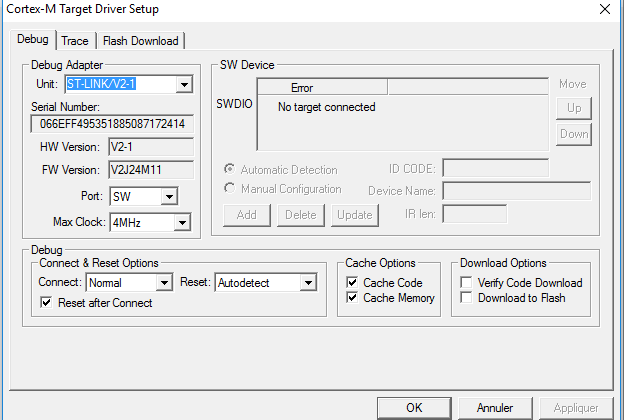

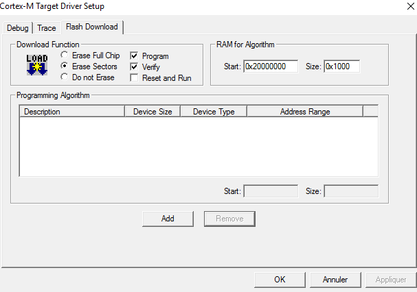

I'm trying to load demo SAI_audio-play from firmware package ''STM32Cube_FW_L4_V1.3.0'' into the flash but I can't, one error send me ==> Error: Flash Download failed - Target DLL has been cancelled.My setting in ''option for target'' are:device tab: STM32L476VG debug tab:2016-02-09 3:02 PM

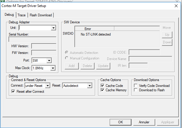

Try ''Connect : Under Reset'' option, or strapping BOOT0 High. You can't debug a device that powers down.

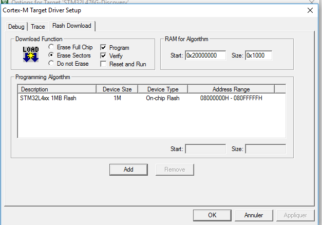

Will definitely need to have the algorithm selected in the menu.2016-02-11 2:21 AM
Thank you, thanks to your piece of advice, I can load the program into the flash memory.
My settings according your specification:2016-02-11 2:46 PM

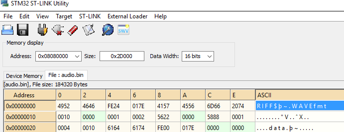

A ''RIFF'' format audio file with length?
RIFF File Formathttps://en.wikipedia.org/wiki/Resource_Interchange_File_Format
https://msdn.microsoft.com/en-us/library/windows/desktop/ee415713%28v=vs.85%29.aspx
2016-02-21 9:08 AM
0x017EFE2446464952
Is RIFF file and if I translate in ASCII code I obtain ==>0x017EFE2446464952
RIFF$þ(SOH)~
