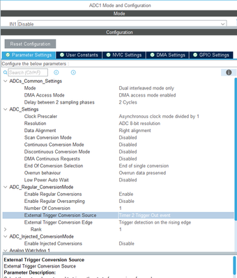

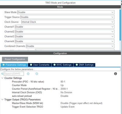

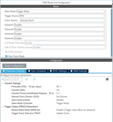

Hi, I am using STM32L476 Nucleo board to generate and read some signals. I am using TIM3 to trigger TIM1 and generate pwm signals. I also used ADC in interleaved continious mode and everything worked out. What I want to do is that I want the ADC and pwm signals to start together and only take 1200 samples(Or sample for a known amount of time) then transmit this data over UART. I tried to trigger ADC from TIM1 using OCREF1 but it breaks the pwm generation part. I tried to add TIM2 and trigger it wit TIM3, then trigger ADC from TIM2. And in ADC callback I added a UART transmit line(Used with continious mode before) but It is not sending anything. What could be the problem or how can I do this in another way. ADC is using MultiDMA for interleave mode. The 2MHz pwm signal is sent every 20ms and after I sample the first 1200 data(Or first 70us lets say), I will use the remaining time to transmit the sampled data.

LL_ADC_SetMultiDMATransfer(ADC123_COMMON,LL_ADC_MULTI_REG_DMA_LIMIT_RES12_10B);
HAL_ADCEx_MultiModeStart_DMA(&hadc1,adcBuf,ADC_BUF_SIZE);
__HAL_DMA_DISABLE_IT(&hdma_adc1,DMA_IT_HT);

// Initialize TIM3 as trigger generator
HAL_TIM_Base_Start(&htim3);

HAL_TIM_OnePulse_Start(&htim2, TIM_CHANNEL_1);

static void MX_ADC1_Init(void)
/* USER CODE BEGIN ADC1_Init 0 */
/* USER CODE END ADC1_Init 0 */
ADC_MultiModeTypeDef multimode = {0};
ADC_ChannelConfTypeDef sConfig = {0};
/* USER CODE BEGIN ADC1_Init 1 */
/* USER CODE END ADC1_Init 1 */
/** Common config
hadc1.Instance = ADC1;
hadc1.Init.ClockPrescaler = ADC_CLOCK_ASYNC_DIV1;
hadc1.Init.Resolution = ADC_RESOLUTION_8B;
hadc1.Init.DataAlign = ADC_DATAALIGN_RIGHT;
hadc1.Init.ScanConvMode = ADC_SCAN_DISABLE;
hadc1.Init.EOCSelection = ADC_EOC_SINGLE_CONV;
hadc1.Init.LowPowerAutoWait = DISABLE;
hadc1.Init.ContinuousConvMode = DISABLE;
hadc1.Init.NbrOfConversion = 1;
hadc1.Init.DiscontinuousConvMode = DISABLE;
hadc1.Init.ExternalTrigConv = ADC_EXTERNALTRIG_T2_TRGO;
hadc1.Init.ExternalTrigConvEdge = ADC_EXTERNALTRIGCONVEDGE_RISING;
hadc1.Init.DMAContinuousRequests = DISABLE;
hadc1.Init.Overrun = ADC_OVR_DATA_PRESERVED;
hadc1.Init.OversamplingMode = DISABLE;
if (HAL_ADC_Init(&hadc1) != HAL_OK)
Error_Handler();
/** Configure the ADC multi-mode
multimode.Mode = ADC_DUALMODE_INTERL;
multimode.DMAAccessMode = ADC_DMAACCESSMODE_8_6_BITS;
multimode.TwoSamplingDelay = ADC_TWOSAMPLINGDELAY_2CYCLES;
if (HAL_ADCEx_MultiModeConfigChannel(&hadc1, &multimode) != HAL_OK)
Error_Handler();
/** Configure Regular Channel
sConfig.Channel = ADC_CHANNEL_5;
sConfig.Rank = ADC_REGULAR_RANK_1;
sConfig.SamplingTime = ADC_SAMPLETIME_2CYCLES_5;
sConfig.SingleDiff = ADC_SINGLE_ENDED;
sConfig.OffsetNumber = ADC_OFFSET_NONE;
sConfig.Offset = 0;
if (HAL_ADC_ConfigChannel(&hadc1, &sConfig) != HAL_OK)
Error_Handler();

* @brief TIM2 Initialization Function
* @PAram None
* @retval None
static void MX_TIM2_Init(void)
/* USER CODE BEGIN TIM2_Init 0 */
/* USER CODE END TIM2_Init 0 */
TIM_ClockConfigTypeDef sClockSourceConfig = {0};
TIM_SlaveConfigTypeDef sSlaveConfig = {0};
TIM_MasterConfigTypeDef sMasterConfig = {0};
/* USER CODE BEGIN TIM2_Init 1 */
/* USER CODE END TIM2_Init 1 */
htim2.Instance = TIM2;
htim2.Init.Prescaler = 80-1;
htim2.Init.CounterMode = TIM_COUNTERMODE_UP;
htim2.Init.Period = 5-1;
htim2.Init.ClockDivision = TIM_CLOCKDIVISION_DIV1;
htim2.Init.AutoReloadPreload = TIM_AUTORELOAD_PRELOAD_DISABLE;
if (HAL_TIM_Base_Init(&htim2) != HAL_OK)
Error_Handler();
sClockSourceConfig.ClockSource = TIM_CLOCKSOURCE_INTERNAL;
if (HAL_TIM_ConfigClockSource(&htim2, &sClockSourceConfig) != HAL_OK)
Error_Handler();
if (HAL_TIM_OnePulse_Init(&htim2, TIM_OPMODE_SINGLE) != HAL_OK)
Error_Handler();
sSlaveConfig.SlaveMode = TIM_SLAVEMODE_TRIGGER;
sSlaveConfig.InputTrigger = TIM_TS_ITR2;
if (HAL_TIM_SlaveConfigSynchro(&htim2, &sSlaveConfig) != HAL_OK)
Error_Handler();
sMasterConfig.MasterOutputTrigger = TIM_TRGO_UPDATE;
if (HAL_TIMEx_MasterConfigSynchronization(&htim2, &sMasterConfig) != HAL_OK)
Error_Handler();
/* USER CODE BEGIN TIM2_Init 2 */
/* USER CODE END TIM2_Init 2 */
* @brief TIM3 Initialization Function
* @PAram None
* @retval None
static void MX_TIM3_Init(void)
/* USER CODE BEGIN TIM3_Init 0 */
/* USER CODE END TIM3_Init 0 */
/* USER CODE BEGIN TIM3_Init 1 */
/* USER CODE END TIM3_Init 1 */
htim3.Instance = TIM3;
htim3.Init.Prescaler = 80-1;
htim3.Init.CounterMode = TIM_COUNTERMODE_UP;
htim3.Init.Period = 2000-1;
htim3.Init.ClockDivision = TIM_CLOCKDIVISION_DIV1;
htim3.Init.AutoReloadPreload = TIM_AUTORELOAD_PRELOAD_DISABLE;
if (HAL_TIM_Base_Init(&htim3) != HAL_OK)
Error_Handler();
if (HAL_TIM_ConfigClockSource(&htim3, &sClockSourceConfig) != HAL_OK)
Error_Handler();
if (HAL_TIMEx_MasterConfigSynchronization(&htim3, &sMasterConfig) != HAL_OK)
Error_Handler();
/* USER CODE BEGIN TIM3_Init 2 */
/* USER CODE END TIM3_Init 2 */

2025-05-06 2:05 AM
Also I found out that ADC is not getting triggered by TIM2 right now, do I need to use "HAL_ADCEx_MultiModeStart_DMA(&hadc1,adcBuf,ADC_BUF_SIZE);" if I am triggering the adc with a timer. Because this is a single line in main and I can see that ADC is only working once
