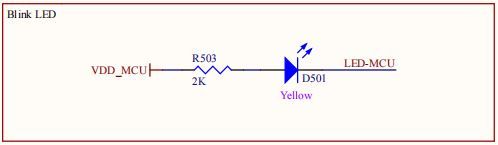

I attached a picture of output circuit schematic. On board there are 4 outputs with same circuit.

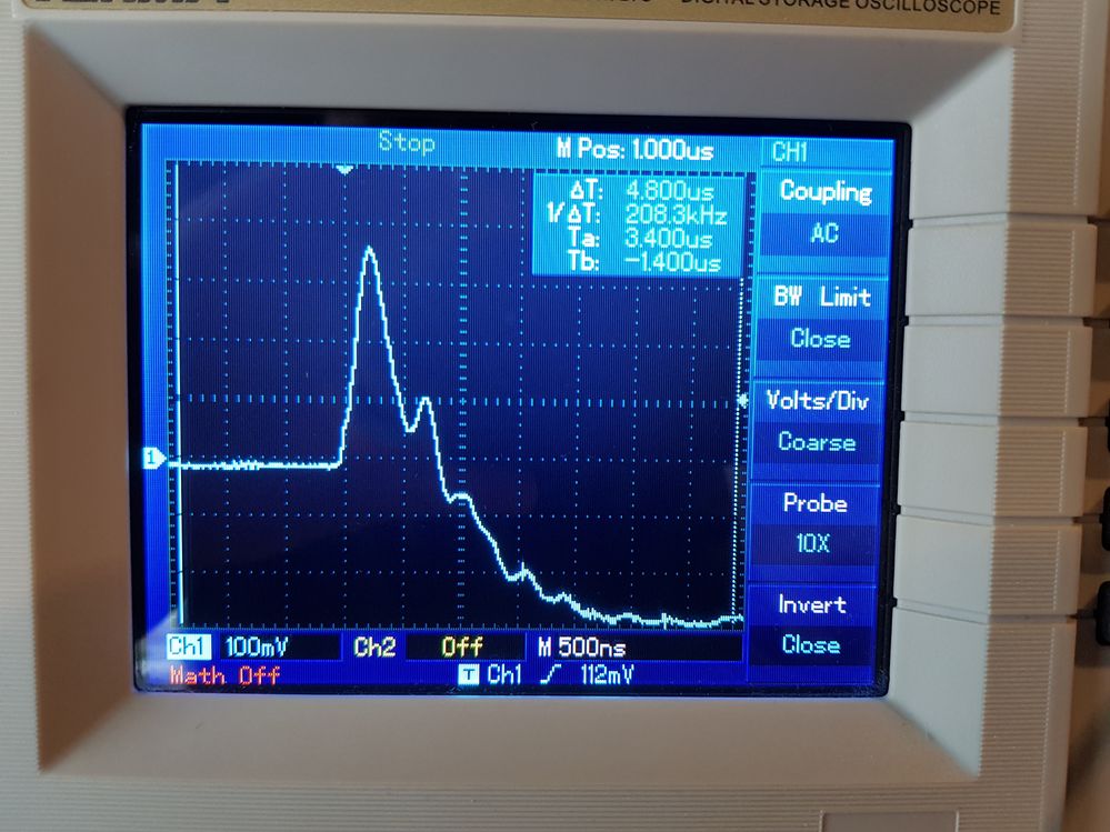

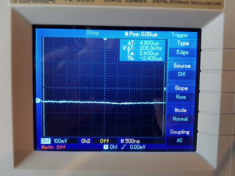

I attached some oscilloscope screen shots to below.
This picture shows the voltage change on the PC13 pin which is configured as output pin, when PB14 pass from low to high.
And picture shows the voltage change on the PC13 pin which is configured as output pin, when PB13 pass from low to high.
This picture shows how PC13 (LED-MCU) is connected.
In addition, fluctuation on PB14 is bigger than the others.
