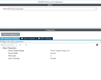

Hi, sorry for insufficient explanation. By "I am enable", I meant that the dual mode option was not there but I think I selected a wrong channel because I am able to select it now but I still have some questions. I enabled IN15 as OPAMP2 Output Single- Ended for both ADC1 and ADC2 and selected "Dual Interleaved Mode Only". I have 2 questions in mind:

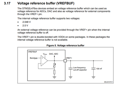

1) As I said I want to capture low voltage signals so I figured it would be a good option to reduce reference voltage and I found this part in MCU datasheet:
In ADC1 settings, there is a checkbox:
Is it enough to set it to shift Vref from 3.3 to 2.048 or how should I set my reference voltage to 2.048?
2) I am not sure how to configure OPAMP2, I need 2 things, one is to offset the signal for like 200mV(To shift it completely to positive side) and other is to amplify it. I understand that I should be able to do both from what is written in this document: https://www.st.com/resource/en/product_training/STM32L4_Analog_Opamp.pdf
I am not sure if I can set this with PGA not connected, also PB0 is for sampling the amplified signals but I am not sure what PA6 is for, I will not be amplifying my signal shifting it more than 1V so I think I also should be able to do it without giving an external bias.
I have looked through some application notes but could not exactly figure out how to set these for my needs so I appreciate any advice.
