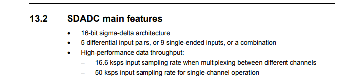

Here is a snippet from page 231
Is it 50Khz or 16.6Khz for a differential channel

you can get 50ks from one ADC - single or diff. input .
so using 2 ADCs in interleaved mode can make 100ks , also on diff. inputs.

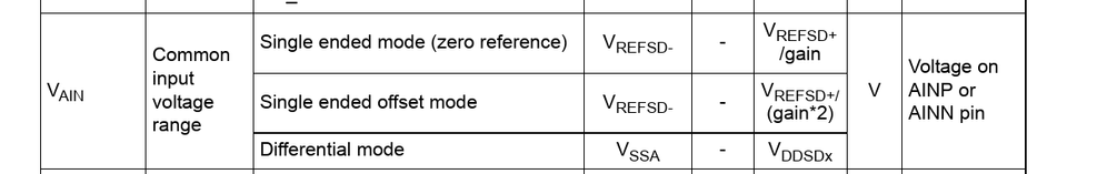

you can put inputs together as in single ended in, just respect the common mode input range (see in ds )

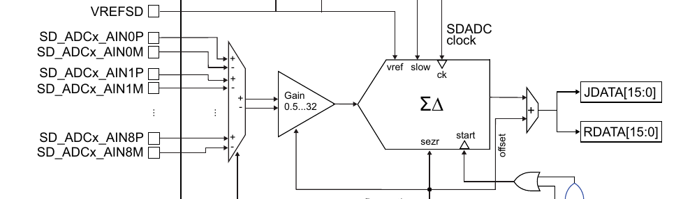

as you can see (15.3 sdadc...) each ADC has its diff/input mux in front:

We will ensure the signal respects and is within the common mode input range we will scale our amplifiers output to ensure it is within the common mode input range for the differential pair

I was just about to post the same image as Ascha, there seems to be a differential amplifier/gain stage just before the ADC, see page 233 of RM0313.
As long as your only measuring a single channel in continuous mode on each SDADC then it should be able to measure 50kHz. (which you are)

good...and i see on quick look at rm no fast/slow channels, only (fast) SAR ADC seem to have such.
see input mux for a channel, always +/- inputs there, can only choose to use them or leave one input at gnd -> single ended then.
so anyway inputs have diff. input stage:

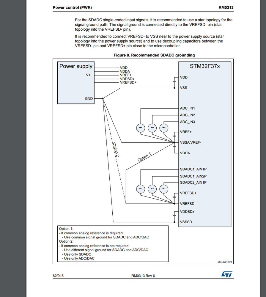

and look for optimum ground ...->

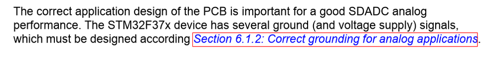

2023-05-26 1:30 AM - edited 2023-11-20 4:42 AM
Dear Ascha.3 many thanks I will read and study Section 6.1.2 Correct Grounding for Analog applications
