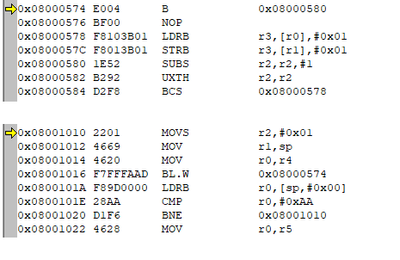

The code is stuck at the following point after pressing "RUN" in debug mode.
It was working well with the same bootloader, but at some point, it stopped functioning.
The same issue occurs on two identical MCUs.

Disassembly isn't too helpful here. I don't think I can help any more without seeing the code where it's hanging. My guess is the HSE or LSE crystal is failing to start.
