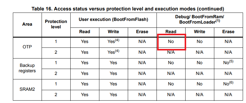

In fact the RDP1 prevents the OTP reading unless the device correctly boots from internal flash. It's not possible to read it out using debug interface. But it remains accessible to user code whatever RDP is set.
PS: which is not the case of G0 products (the thread I have referred above)

It is not used by ST for factory data. Once programmed, OTP data cannot be changed or erased, but it can be read. OTP area can't be read when RDP (Readout Protection) is activated according to the reference manual:
But I need to check internally if that is a typo or not! I will get you back for the right answer. (I'm referring to this thread). internal ticket for follow-up: 227713

hello @mƎALLEm , OTP area can't be read when RDP (Readout Protection) is activated is only when booting is from RAM/boot from loader/ or if a debug is detected . but if booting is from flash then we can read OTP area even if RDP is Activated right ??
2026-02-23 1:45 AM - edited 2026-02-23 1:46 AM
Of course it could be read from the application from the flash otherwise it doesn't have sense.
But need to confirm if the table states the correct policy. I have a doubt the OPT can't be protected by RDP level 1.
I'm waiting a confirmation from an internal expert.
