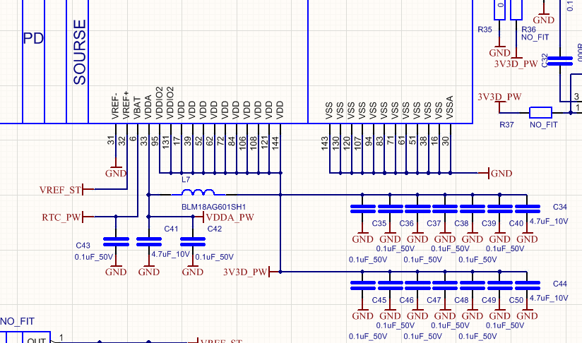

Does it not react to NRST either? Is VDDA properly decoupled to VSSA? Double check also the soldering of the pins.

Power pins decoupling on the picture.
