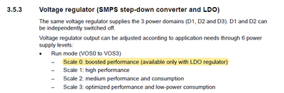

That's normal. You're using SMPS in boosted performance (VOS0) which is not allowed in the spec.
In SMPS configuration, the maximum frequency you can reach is 400MHz @VOS1. Only LDO can be used with VOS0.
This is already mentioned in the datasheet:

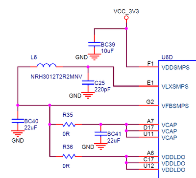

2024-02-17 10:57 PM - edited 2024-02-17 11:01 PM
Thank you for answering my Problem.
I would appreciate it if you could refer to the picture above.
above picture is direct SMPS supply mode schmethics.

Hi @KimJaeJoon ,
May be : BC41 value seems very high and should be 2,2uF , BC40 value is too high also / close to the inductor .

Hello @KimJaeJoon ,
Also as said by @STOne-32 22uF is not the right value recommended for VCAP pins.
Please refer to NUCLEO-H745ZI-Q board schematics:
https://www.st.com/resource/en/schematic_pack/mb1363-h745ziq-d01_schematic.pdf
