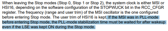

Also, please consider this input from the reference manual:
-Amel

That quote from the Reference Manual indicates that PLL mode essentially starts over when exiting stop mode, so the application cannot expect the MSI frequency to be stable until the stabilization time has elapsed after each wakeup. In my application, if the current operation requires MSI to be stable, I do wait. Otherwise I don't wait and could end up with scenarios like the one above (run mode for only 100-200 microseconds) when there is very little work to do.
