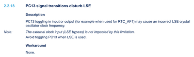

2024-03-30 12:47 AM
In the newest STM32F407 errata (ES0182 - Rev 15, 12-Feb-2024 ) the erratum in question has been rephrased (it's the only change in this version of errata):
(I guess other errata have been updated with similar wording, did not check).
