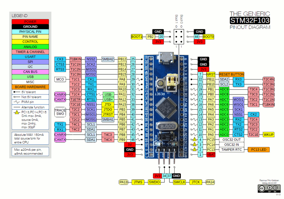

Curious detail on the huge spread "blue pill" boards :
the LED is on pin ..what is to be expected? PC13 !
2023-05-27 5:04 AM
Poor choice in general as it's a low power / current pin too.

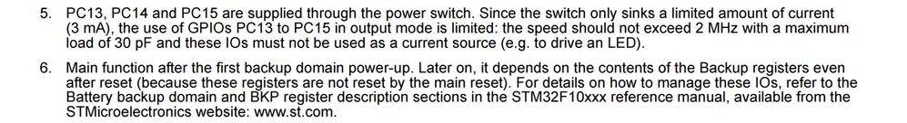

from F103 ds .Table 5 .
2023-05-30 1:56 AM
The description in the errata of the STM32F407 is much clearer to me. I also notice, that the errata entry was only added in February 2023. So, I wonder what is with older designs out there...
2023-05-30 2:42 AM
In this respect, PC13 on 'F1xx is no different from PC13 on other STM32 (perhaps except 'L0) - they all are in the VBAT domain behind the current-limited switch, and their GPIO function is overriden by RTC.
