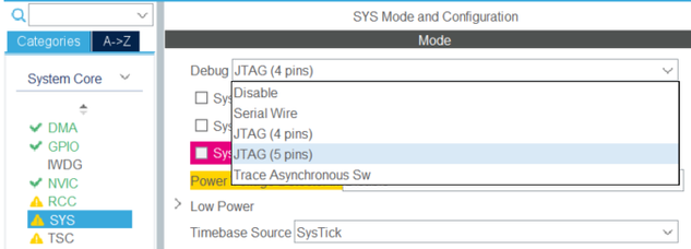

In STM32CubeIDE, the SYS configuration has serial wire, JTAG (4 pins) and JTAG (5 pins).
I noticed that JTAG (4 pins) uses an extra pin for "SWO" (PB3) and JTAG (5 pins) uses an extra pin "SYS_JRST" (PB4).
Would I need these pins too ?

2025-07-07 7:20 PM - edited 2025-07-07 7:21 PM
SWO is not needed or used for flashing. Not sure if SYS_JRST is required for JTAG.
It's silly to program in so many different ways to flash the chip. Use SWD for development and be done with it. If user updates are needed, choose (LP)UART or USB and have those available. You will need to be able to jump to the bootloader for these, unlike with SWD.
