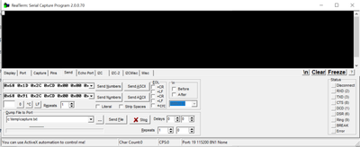

I am sending data with RealTerm. Short messages work just fine, but then I need to send 147 bytes. In the debug, I can see from the state of huart2 handler that RxXferCount starts at 147 and decrements until 98. Then, UART_RxISR_8BIT is never called again, the state remains unchanged until firmware's timeout triggers and aborts the reception.
I tried to look at some other things. RTS and CTS pins are low at the time when timeout happens. The timeout was initially 0.02s, I raised it to 1s with no effect. Overrun flag is low as well. My buffer is larger than the message I am expecting. I tried to use UART_Receive_IT in batches of 32 bytes, but then the first batch is received correctly and the second batch freezes in the similar way as soon as the total amount of received bytes reaches 49. I am not supposed to reset something between UART_Receive_IT calls, correct?

After a couple of tests I found out that Realterm v2.0.0.7 does not send more than 49 bytes in one go for some reason. I used a makeshift python script to send the data and it worked. Good grief, threw me for quite a loop.

I send the whole message package together by inserting the data and pressing Send Numbers.
