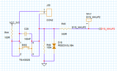

The possible looping circuit that might consume power:
The battery block
The 3.3V and 5V block

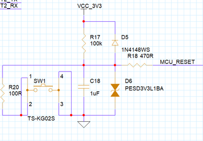

The MCU reset circuit

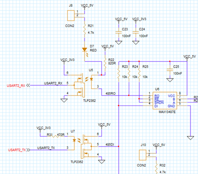

The 485 transceiver circuit. The 5V is turned on only at the time of reading sensors.

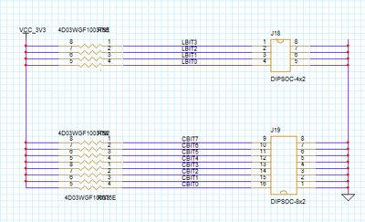

We also use some DIP switches to set up the address of the device.

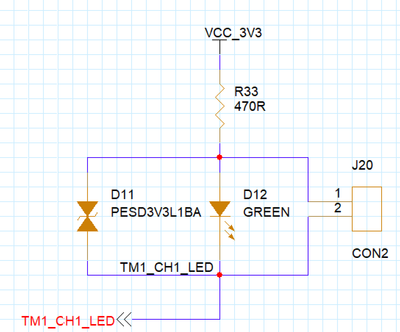

The LED circuit with PWM as indicator.
The WAKUP circuit with a button key.

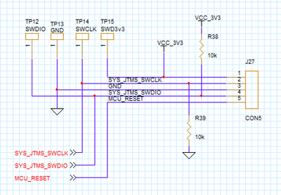

SWD circuit for downloading code to the MCU.

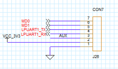

The RF module works at 3.3V. It has a low power mode and works good. The system consumes 1.33mA with or without the RF module.

Hello @NEdom.1,
Make sure the low power modes' debug options are off. The debug module and some internal clocks can remain active during low-power modes, you can disable these options by clearing the debug bits in the DBG_CR register, check this article: Increased consumption in low power modes - STMicroelectronics Community
2025-03-03 1:35 AM
@Sarra.S wrote:Make sure the low power modes' debug options are off.
+1
@NEdom.1 also ensure that the debugger is physically disconnected - otherwise you will get leakage into the connection.

Thank you Sarra. Should I clear the debug bits right before going to sleep, or just the moment after a wakeup-reset cycle?
I have already put the code at the beginning of the low power function.

Tried adding the DBGMCU bits macros to disable debug options but no effect in decreasing the power consumption.
2025-03-06 12:03 AM - edited 2025-03-06 1:57 AM
YES. I have already disconnected the SWD debug pins. Thank you for reminding.
