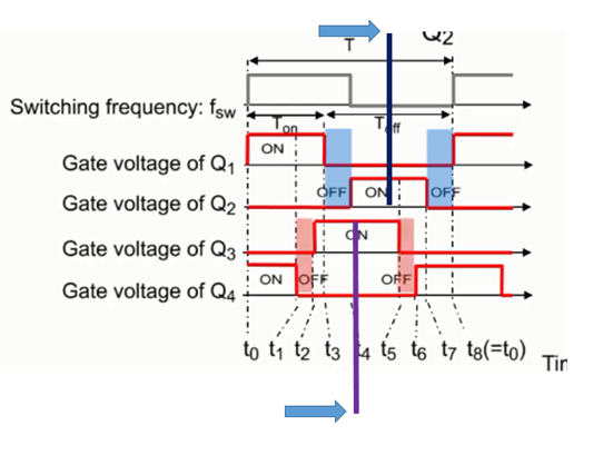

the same interval
there is lag between themHi ,I use stm32f401rct6 board ,I need to generate two pairs of complemdntary pwm signal to drive 4 igbt for dc full bridge converter in soft switching way,
How can achieve two pairs by some leg between them as shown in picture?

2025-03-05 2:26 PM
When set TIM1 CH1 and CH2 to generate two pair of complementary signal there is no lag between them, but I need to make lag as shown in picure

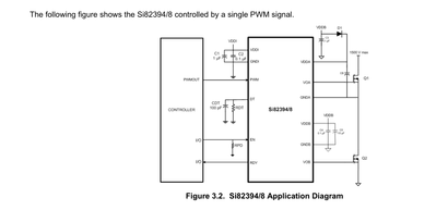

2025-03-06 12:34 AM
You need/want two complimentary signals with delay between them ,
so need :
- two timers with can have deadtime (maybe F303)
- a very complex "advanced" timer , that can generate "combined mode" with complimentary channels
- use your actual F401 and its timers to just make two 50:50 pwm signals, that can have phase shift from 0...100% between the output signals, and do the complimentary signal and deadtime with a gate driver, that have built in deadtime. (I used Si82394 for this, or IRS2008 ; or just look at mouser , there are many drivers to choose:
