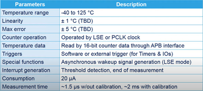

2025-03-05 11:46 PM
I found this for different microcontroller DTS , is this table relevant for the STM32H562 DTS also?
what is the frequency of PCLK and LSE?
