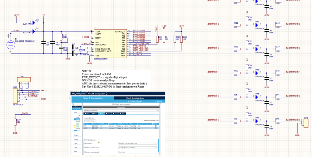

That could be due to one (or more) of the GPIO pins floating to an intermediate voltage (somewhere between Vdd and Vss).
If these pins are set as digital inputs the input circuitry looks like a CMOS inverter, where you have an NMOS transistor with its source connected to Vss and a PMOS transistor with its source connected to Vdd; the gates both going to the input pin and the drains connected together.
If the input pin is at Vss, the NMOS transistor is off (and the PMOS is on).
If the input pin is at Vdd, the PMOS transistor is off (and the NMOS is on).
If the input pin is at a voltage between Vss and Vdd, both transistors are partly on, and "class A" current flows between Vdd and Vss - increased supply current.
There are various fixes.
If you want the pin to remain as a digital input, pull it high or low with a resistor (either externally or turn on a built-in pull-up or pull-down).
Or you could program the pin to be digital output. Or set it "analog" which disables the digital input.
as you can see in the schematic, the inputs need to be used as intrusion event, and are pulled up with a 1M5 resistor.
Danish1
Lead III
PB1? (I can't see if that's wired to BOOT0)
SWDIO? SWCLK? (I know these often have pulls)
Boot0 -> 10k to GND
PB1 is configured as output low.
SWDIO and SWCLK just go to the debug connector and do not have Pull Up or Down configuration in ioc
