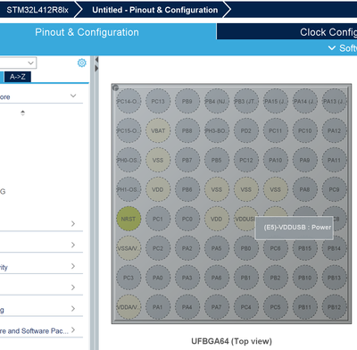

VDDUSB is pin E5 on the STM32L412R8I. It is independent from VDD. You can have VDD = 1.8 V and VDDUSB = 3.3 V.
Power that with 3.3 V when USB is present and things should work.
