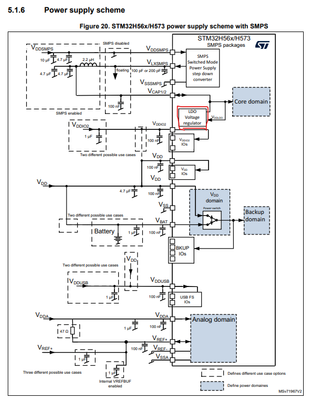

I think it has both option. Even for SMPS power scheme, there is a LDO shown internal to uC. Refer below image: Please let me know if my understanding is correct.
Indeed the LDO is there on the die but it is disabled by HW as already said in RM section 10.5.1.

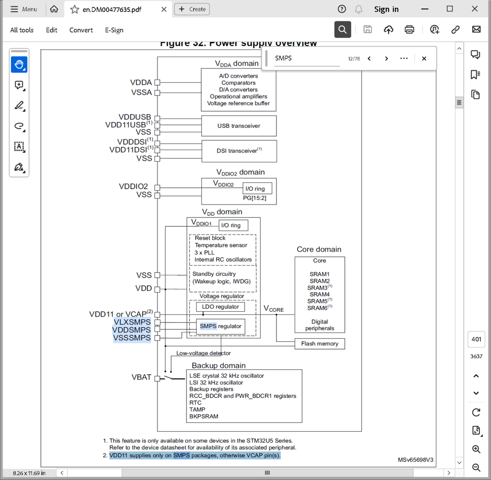

I was also a bit confused on my STM32U5A5 with LDO vs. SPMS:
  • these are two different order options!
  • the pins are different
  • if SMPS chip version - you have to enable SMPS
As I understand it: there is NOT an option to decide between LDO or SMPS (it is a bonding feature, a package feature).
And my datasheet says clearly (as I understand): SMPS version does not have CAP for LDO. So, I assume, there is not an LDO option.
It might be misleading to see "LDO regulator": potentially, it should be marked as "bonding variant". The note 2. makes it clear for me, that LDO is not an option on an SMPS package.
