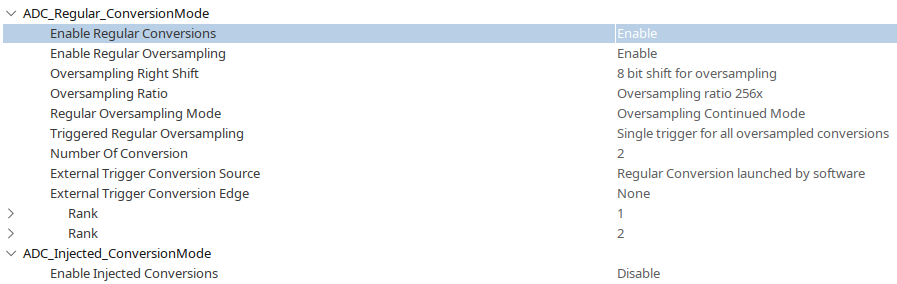

I'm using ADC1 to measure the Temperature Sensor channel and the Vrefint channel. I expect those to vary very slowly and I am in not in a hurry so I am maximizing the sampling time. These are my settings in STM32CubeIDE:

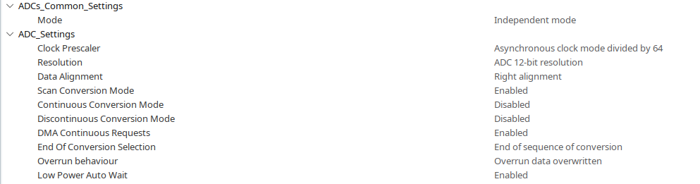

The ADC clock is set to PLLSAI1R, and
printf("ADC1 clock freq.: %lu\n", HAL_RCCEx_GetPeriphCLKFreq(RCC_PERIPHCLK_ADC));
prints "ADC1 clock freq.: 48000000".
EDIT: ADC_CCR is
// 3 2 1
// 10987654321098765432109876543210
0b111001000000000000000000
Bits 21:18 PRESC[3:0]: ADC prescaler: 1001: input ADC clock divided by 64

I see it now. Even though I selected Enable Regular Conversions: Enable in STM32CubeIDE:
that, apparently, doesn't do anything. It's up to the user to manually set
Bit 0 ROVSE: Regular Oversampling Enable
This bit is set and cleared by software to enable regular oversampling.
0: Regular Oversampling disabled
1: Regular Oversampling enabled
I added
ADC1->CFGR2 |= ADC_CFGR2_ROVSE_Msk;
to my initialization function and now I am getting "EOS wait: 445799 us", which is what I expected in the first place.

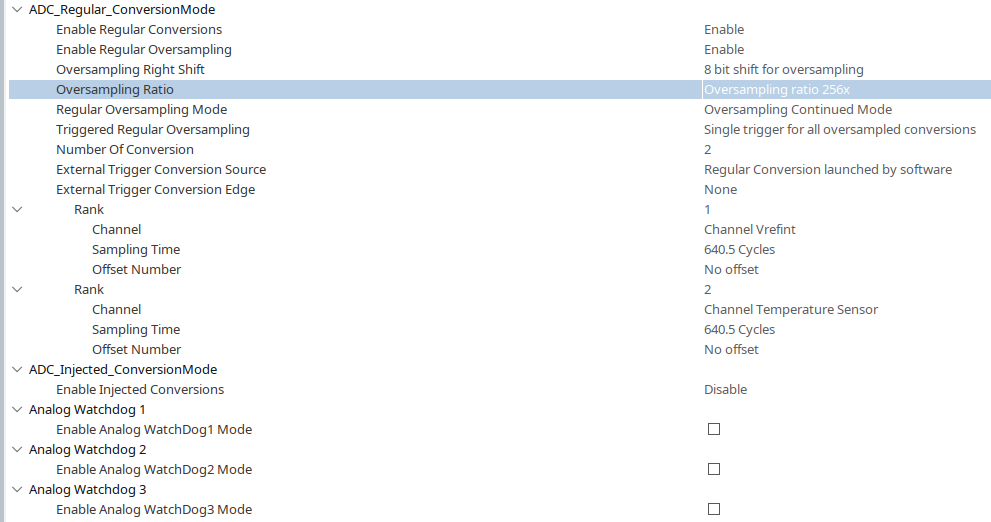

The error is a factor of approx 256, so it must be the oversampling ratio functionality.
The ratio bits are correctly set, so perhaps it is something in setting ROVS.
2024-05-17 2:13 PM
@raptorhal2 wrote:The error is a factor of approx 256, so it must be the oversampling ratio functionality.
I agree. I'm beginning to think oversampling doesn't work at all on this chip.
I have ROVS at 0.

2024-05-17 2:39 PM - edited 2024-05-17 2:41 PM
I added
