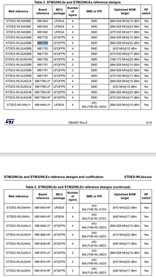

For the questions about the Pins that are not available on the STM32WL55CC, you can refer to the DS13293. For the reference designs, you can refer to one of the designs dedicated to the UFQFPN package on this table:
Best Regards.

Hello @rohithinthingstech
Best Regards.
