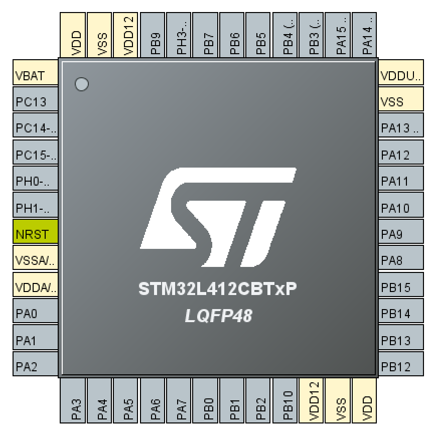

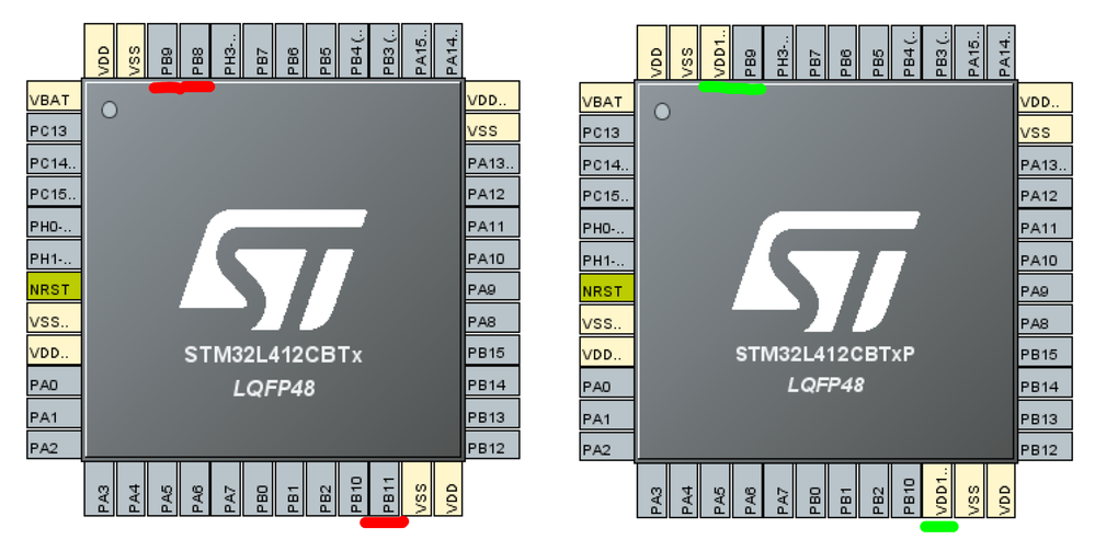

> CubeIDE has the same problem, there aren't any pinout differences between these two kinds of Part Numbers.
Sure seem different to me in STM32CubeIDE:

2020-12-04 11:06 AM
You are right.
I was choosing the device by the generic Part Number, that automatically selects the version without P.
I didn't realize that was possible to choose the device by the reference.
My mistake.
Thanks.
