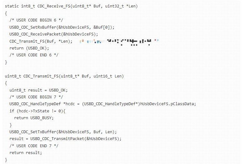

The STM32USB library calls the function CDC TransmitFS, which can only be sent in the CDC ReceiveFS loop and data in the main. The cdc ->TxState flag has always been 1, so only the USBD_cDC SetTxBuffer was successfully called. However, the USBD_cDC TransmitPacket, USBD_cDC DataIn, and subsequent CDC TransmitCplt cannot be called.
There are two solutions to watching the forum: 1. Place it in an interrupt with the same priority as USB and call CDC TransmitFS to send it. Only the call succeeds 2. 'Call this function EP0_RxReady before sending. But both methods can cause the program to freeze.
Both CDC_Receive_FS and CDC_Transmit_FS are implemented in usbd_cdc_if. c. Calling CDC_Receive_FS in CDC_Receive_FS can send and receive messages in a normal loopback.
The following is the implementation of two functions:

Thanks,I am developing STM32L4R7VIT6 on my circuit board.How can I deliver this whole project to you.
Now, I am using USBD_LL_Transmit() instead of CDC_Transmit_FS() to send messages,it works.
I'm not sure if there are any issues with directly using the lower sending function, but the fact is that it can work normally.
