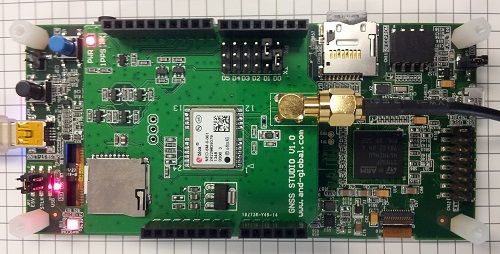

Hi, I just wanted to connect a STM32 to a GPS using a SPI with DMA. Here is my setting :
la : LOGICPORT LA1034 board : NUCLEO-L476RG mcu : STM32L476RGT6 gps : EVA-7M cube : 4.13.0 lib : HAL 1.3.0 clock : 80 MHz spi : SPI3, master, full duplex, 2 wires, prescaler 256 (312 kHz), no NSS dma : DMA2_Rq3_Ch1 as Rx, DMA2_Rq3_Ch2 as Tx, BYTE The scenario is as follow : > STM32 send a 6 bytes UBX polling request frame using HAL_SPI_Transmit_DMA > The logic analyzer 'see' the frame being sent > After a while, I try to read the 6 first bytes from the answered UBX frame Here are the results of my analysis : 1- Trying to receive 6 bytes using HAL_SPI_Receive_DMA into memory @ 'bufUbx' (multiple of 8) expected frame : B5 62 0A 04 | 64 00 expected @ bufUbx : B5 62 0A 04 | 64 00 .. .. | .. .. .. .. | .. .. .. ..??
