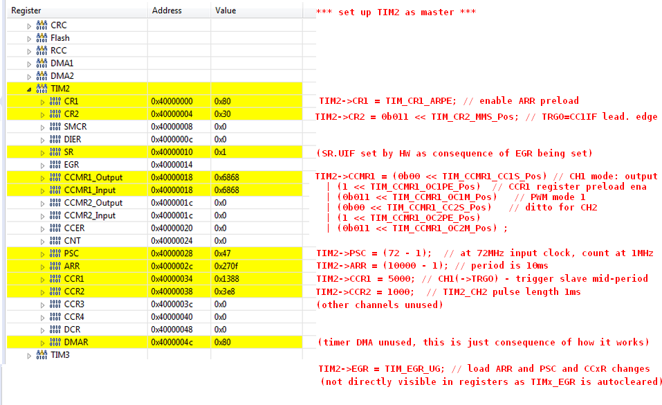

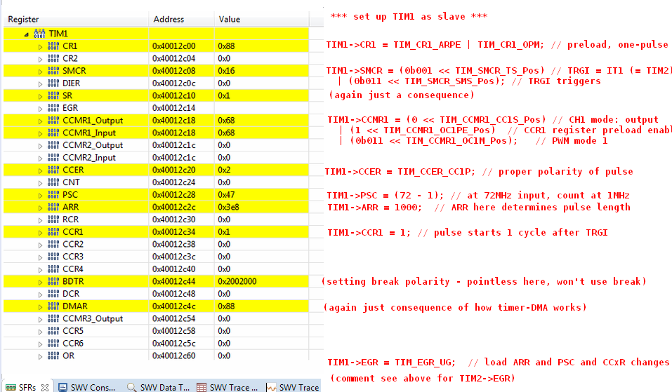

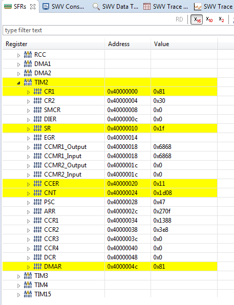

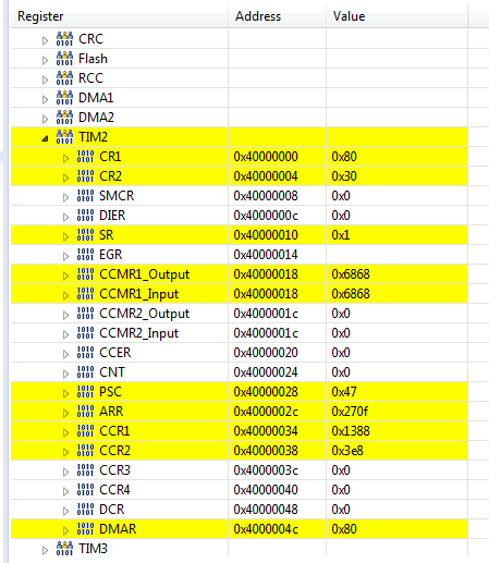

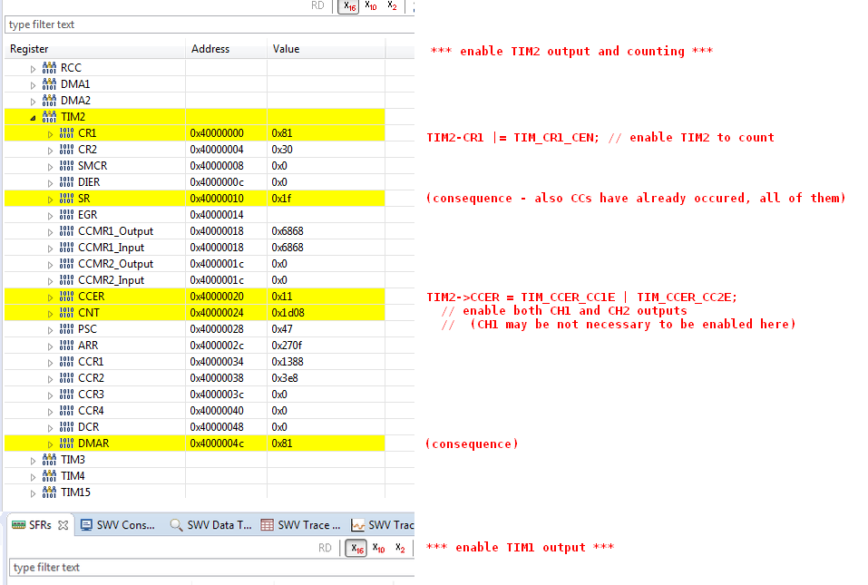

I hope this is what you wanted!
After Master (TIM2) INIT;

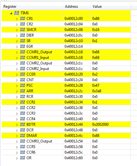

After Slave (TIM1) INIT;
After Master (TIM2) PWM Starts;

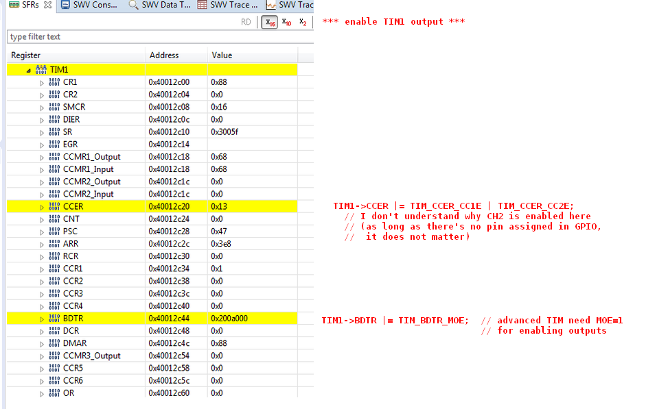

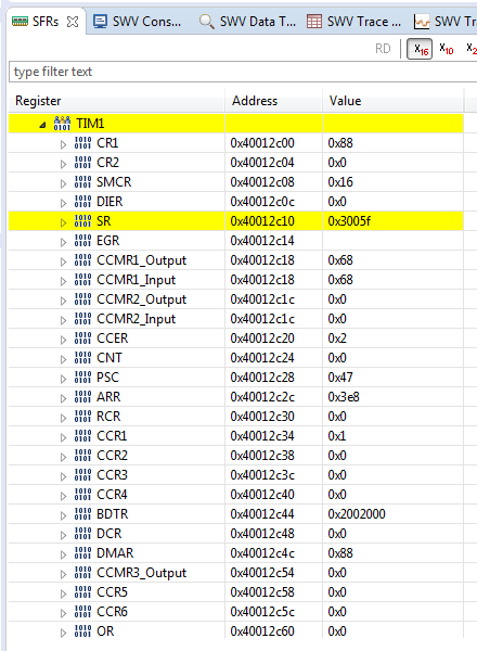

Slave (TIM1) after Master PWM Starts only:

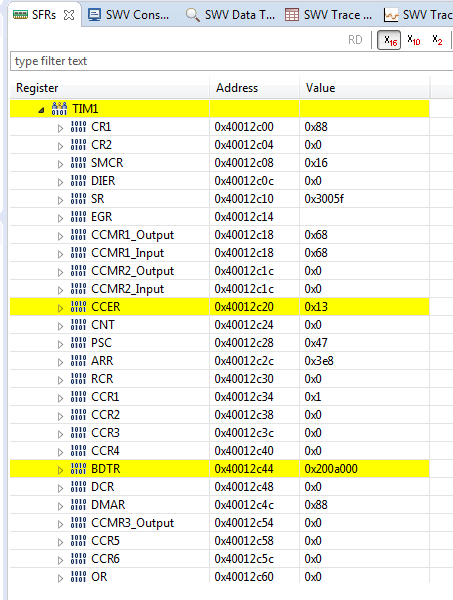

finally after SLAVE (TIM1) PWM Startup

John,
thanks for the details.
I ''decomposed'' it into register accesses, and then modified it for a simple demo program (in attachment).
It may seem that there's quite a lot of typing; but in fact, once you already set up a timer in this manner, it's mostly copy/paste/modify, and the possibility to add comments as appropriate is IMO a bonus.
________________ Attachments : tim master slave.zip : https://st--c.eu10.content.force.com/sfc/dist/version/download/?oid=00Db0000000YtG6&ids=0680X000006HxqD&d=%2Fa%2F0X0000000b2Z%2FcWdA2s9Ylx1iY.bsBn_U8u5UF5Rb94kZ_lhsE3RxFnU&asPdf=false2018-02-25 8:27 AM

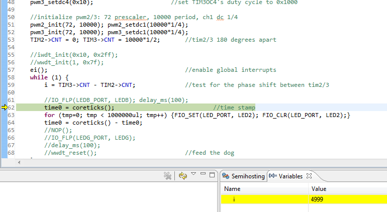

here is a screen capture of a debug session for the code above.
as you can see, the difference between TIM2->CNT and TIM3->CNT is 4999 (it actually oscillates between 4999 and -5001: the 1 count off is due to execution of the two TIM2/3->CNT assignment statements, and the negative sign is due to counter roll-over from ARR).
