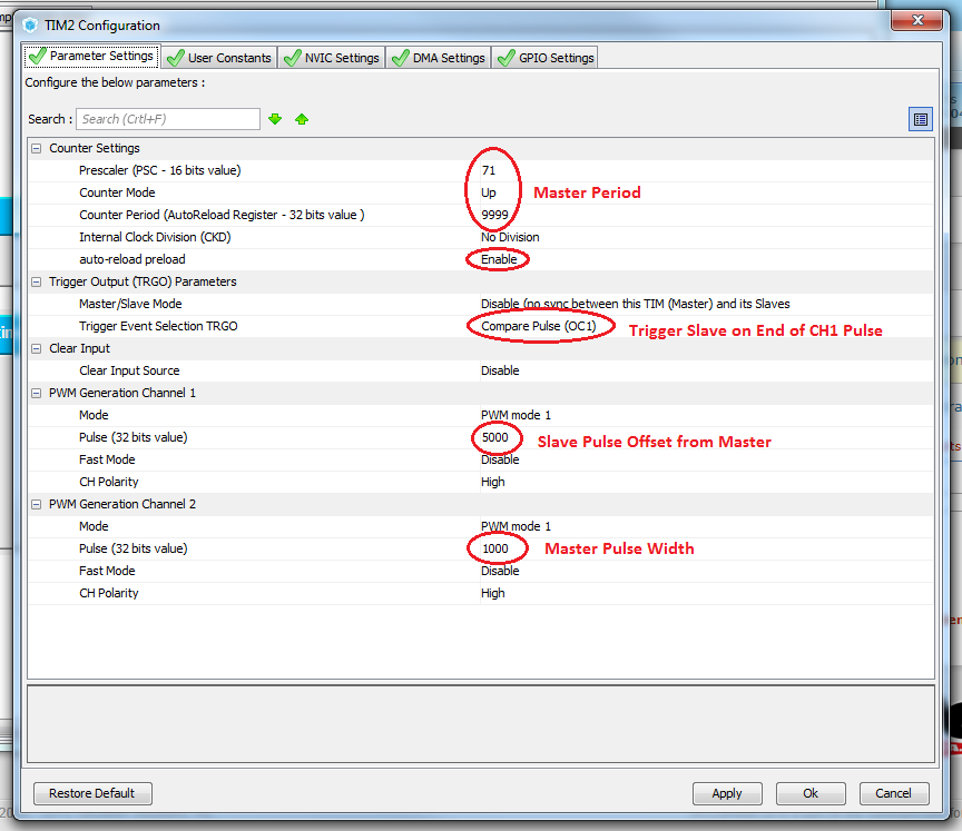

The alternative, which is probably a little cleaner,(no math and single calls for each parameter change):
add PWM on CH2 to master timer, using this as master output pulse.
use PWM on CH1 on master as the phase shift.
change master TRGO to the Compare Pulse (OC1) event

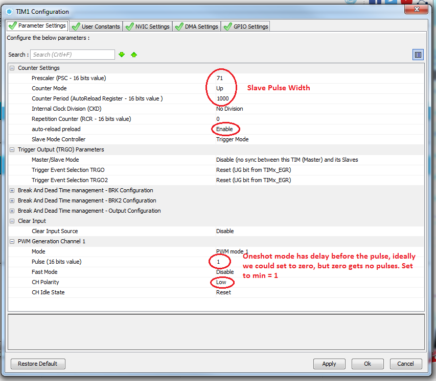

Set Slave CH1 pulse width to 1 (delay before the pulse, must be > zero)
then start things with;
HAL_TIM_PWM_Start(&htim2, TIM_CHANNEL_1); HAL_TIM_PWM_Start(&htim2, TIM_CHANNEL_2); HAL_TIM_OnePulse_Start(&htim1, TIM_CHANNEL_1);
use these to make changes to timing;
__HAL_TIM_SET_AUTORELOAD(&htim2, period); //set master period __HAL_TIM_SET_COMPARE(&htim2, TIM_CHANNEL_2, tm); //set master pulse width __HAL_TIM_SET_COMPARE(&htim2, TIM_CHANNEL_1, (offset-1)); //set slave pulse offset __HAL_TIM_SET_AUTORELOAD(&htim1, ts); //set slave pulse width // change period with 180deg phase
__HAL_TIM_SET_AUTORELOAD(&htim2, newperiod); //set master period __HAL_TIM_SET_COMPARE(&htim2, TIM_CHANNEL_1, ( newperiod/2 -1)); //set slave pulse offset2018-02-20 8:59 AM

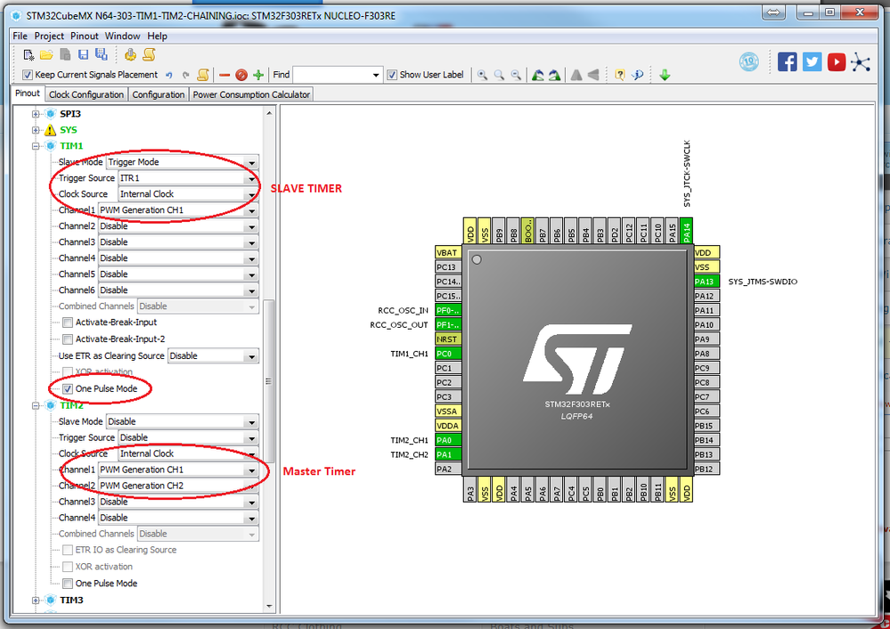

For CubeMX users, this is the setup for the clean code alternative i posted.
2018-02-20 9:53 AM
Very helpful...thanks, I will test it out a bit later today.
