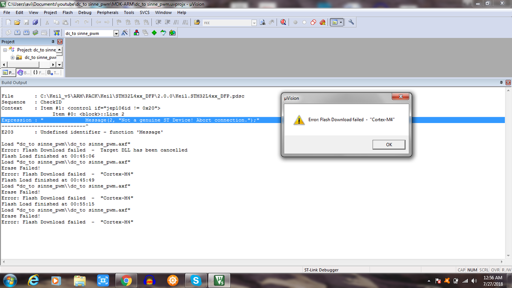

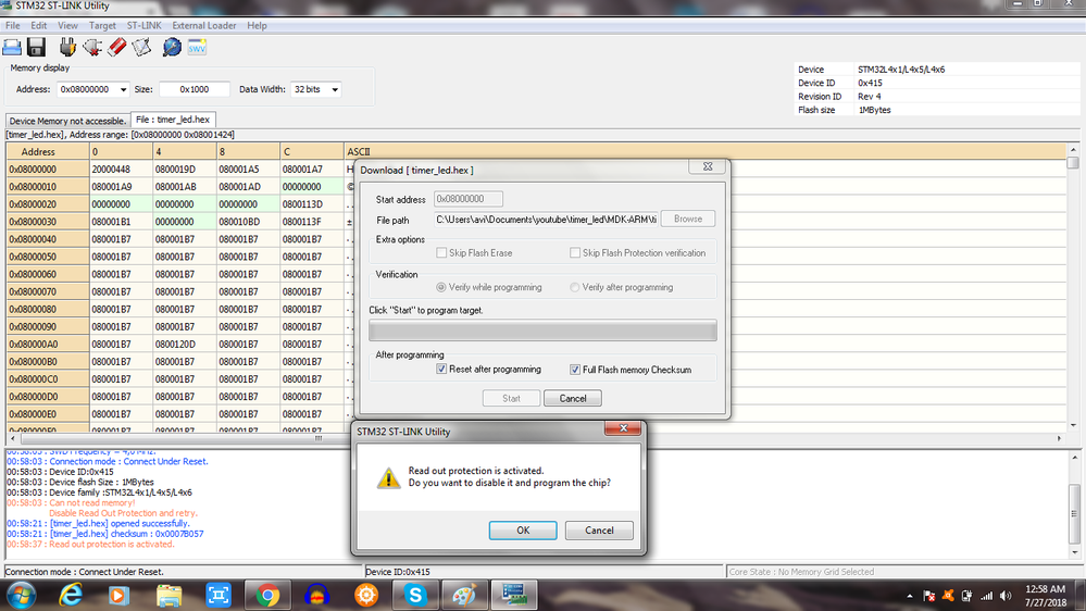

I have a STM32L476RG nucleo board.Recently when I tried to program it using keil I found some error messages and I was unable to program it.
I found that LD3 LED is glowing .Initially when the board was programmable it was not glowing.
I am attaching error messages of keil 5 and stlink utility.Please help to solve this problem.

Thank you ,keeping the Boot0 pin low worked for me.I was able to erase chip fully while keeping the boot0 pin low.Now I am able to program the board using keil.
