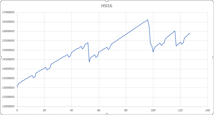

2021-04-12 9:56 AM
It was reproducable with every restart.
Here you see the relation HSI16 frequency to calibration value (0..127).
The measurement was done with the LSE 32768Hz 100ppm mean of 10x LSE trigger divided by 8.
