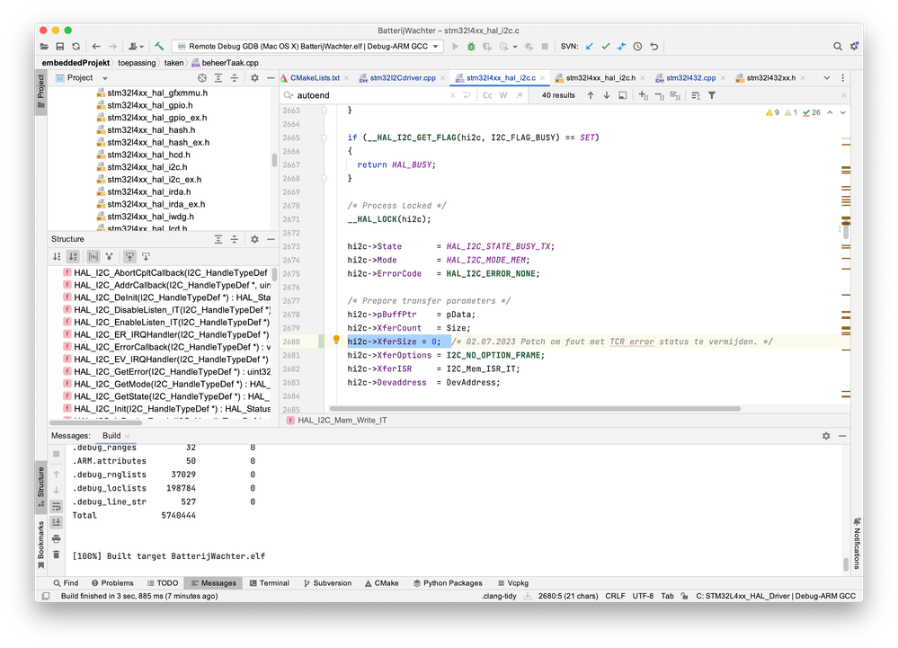

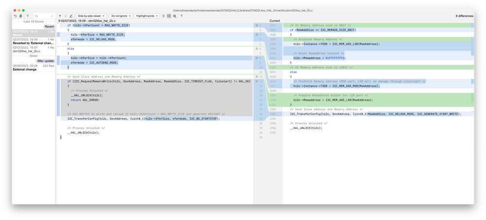

I applied a fix to the driver by setting the XferSize member variable to 0. Doing this made the ISR routine perform without any errors, and my application runs again without problems.:
I reckon this fix, if valid, should also be applied to the the HAL_I2C_Mem_Read_IT function.
Perhaps someone from ST can comment on this?
With best regards,
Ewout Boks

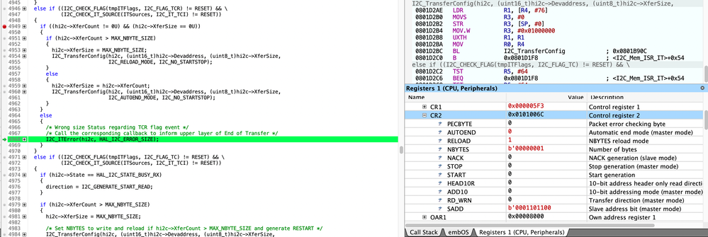

Thanks for your reply. My take on it is that the XferSize variable holds a value after an I2C transfer. Then, when doing the next transfer the old value would be in the way and interfere with the new setup in the HAL function, which splits the transfer in a few parts using the RELOAD feature of the I2C hardware. The reset of XferSize to 0 is required.
