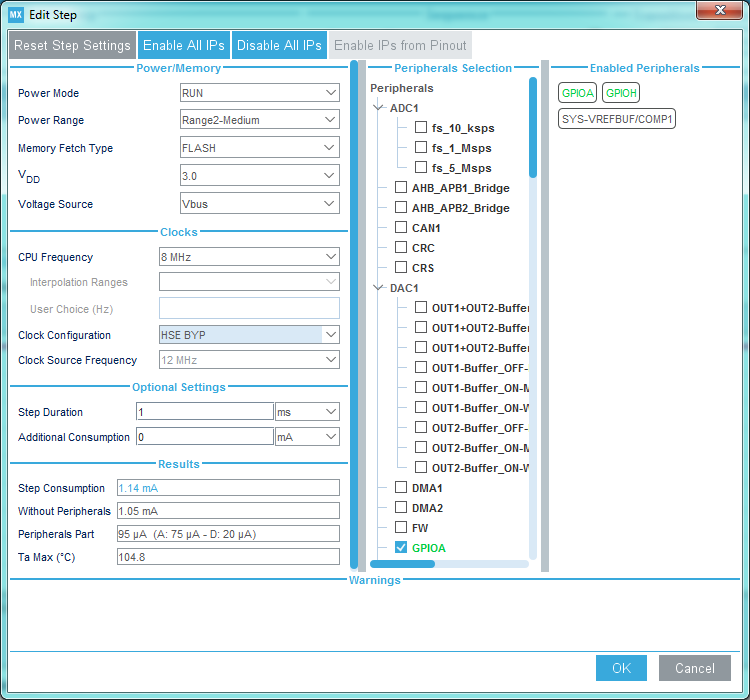

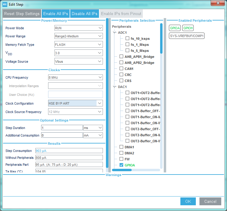

Now in STM32CubeMX, he created an empty project on stm32l431cb, turned on only external 8MHz quartz and SWD. Enabled ART Accelerator by enabling Prefetch, Instruction cache, Data cache. It does not have a separate enable bit, as I understand it, it is turned on by turning on cache and prefetch. Set PWR to Range 2. If you believe the power consumption calculator: consumption should be 903μA.
On the multimeter, I see 1.41mA (tested on several, plus an attorney), if you consider that somehow ART Accelerator is not turned on, then the consumption should still be 1.14mA:
On the diagram, it wasn’t worth anything except the controller and its bindings. Why the consumption values do not coincide very much with the calculated and indicated in the Datashits? What am I doing wrong?

P.S. Could you still help with my previous message? I can’t understand why my current consumption is bigger than the calculated value? In run mode, I connected only the external quartz resonator and the SWD interface, and the consumption was 1.41mA but should be ~ 900uA.
