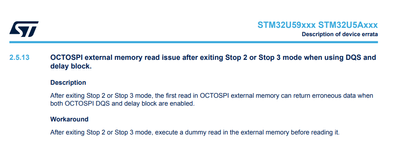

We’ve developed our own board based on the STM32U5A5 device, using the same architecture as the B-U585I-IOT02A. Sadly, we’re encountering the same issue: a hard fault handler is triggered when accessing external RAM after exiting Stop2 mode. I saw an interresting thing in the STM32U5A5 errata sheet which may linked to my issue. But my workaround does not work.

Hello @pascal38 ,
If you use STM32U5A5 device, please make sure after exiting Stop 2 or Stop 3 mode, execute a dummy read in the external memory before reading it.

Thanks Kaouthar,
yes I have read this errata sheet and I have tried dummy read. Perhaps I did not do that correctly but it did not solve my issue. I do something like this after exiting low power and clocks reconfiguration :
volatile uint8_t *temp = (uint8_t *) OCTOSPI1_BASE;
uint8_t dummy = *temp;
...I work with DQS enable (OctoSPI settings directly comes from OSPI_PSRAM_MemoryMapped cubeMx example project).
