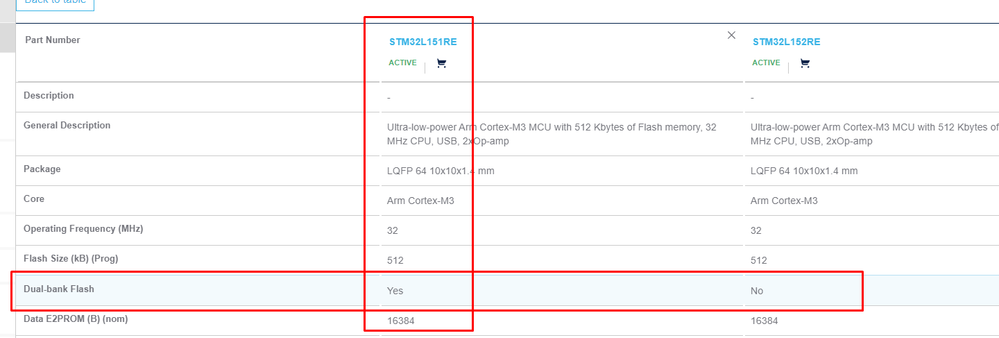

by the way, there is some missleading information about wich one have or not the dual bank mode, in datasheet it says that MCU cat 4/5/6 have dual bank, but in the product selector only the STM32L151RE has it... i tested the with both 151 and 152, none of then worked.
