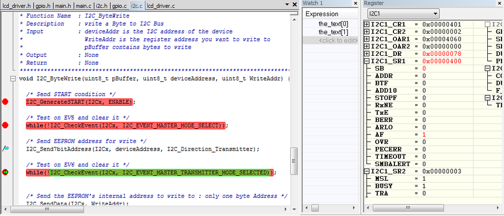

Try a quick and dirty value ''I2C_SPEED1 / 2'' into the I2C init structure, that should divide by 2 the frequency. Check your scope measurement.
The exact bitrate is derived from what function RCC_GetClocksFreq returns. What is your quartz frequency (assuming you are using one to drive HSE, then PLL) ?2014-02-13 6:08 AM
OK I divided the I2C clock speed by 2. Now I see the whole clock and data after sending the I2C_Send7BitAddress. Still it gets stuck on the EV6 flag check.
This is the screenshot of the scope.2014-02-13 7:29 AM
Well, I2C_SR1 AF bit and your scope trace show the same thing: your device does not answer. The slave should have force SDA to zero on the 9th clock bit, which does not happen.
Either your slave is lost (I2C slaves may requires manual resync) or the slave address is wrong. Data sheet are not very clear about I2C addresses, try with 0x78, 0x7a, 0x7c and 0x7e.2014-02-16 12:29 AM
I tried the 4 possibilities you suggested for the value of the slave address but none of them work, all give the same result. It is still stuck on the EV6 flag.
How can I do a manual resync of the LCD?Thanks!2014-02-17 1:39 AM
''I tried the 4 possibilities you suggested for the value of the slave address but none of them work, all give the same result. It is still stuck on the EV6 flag.
How can I do a manual resync of the LCD?'' What do you mean by ''re-sync''? If you mean - get I2C working - your guess is as good as ours right now. Laurent spotted the I2C freq was wrong - great work there! The device you are using does not comply with I2C! You can try sending a stop bit to end comms. You can try resetting the LCD device (if you have the LCD reset under STM32 control).2014-02-22 10:09 PM
