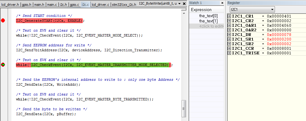

2014-02-13 2:35 AM
I believe that until the while the configuration is correct. Here is a screenshot of the registers.
I2C_EVENT_MASTER_BYTE_TRANSMITTED,
if that's the case it is defined as I2C_EVENT_MASTER_BYTE_TRANSMITTED ((uint32_t)0x00070084)Thanks!2014-02-13 2:59 AM
