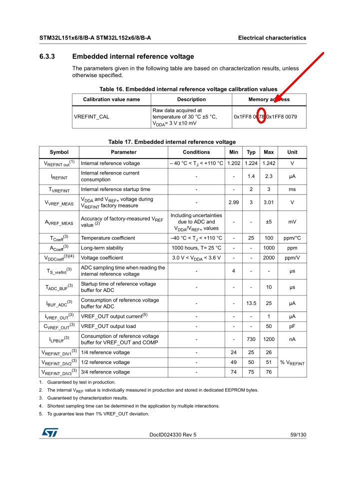

waclawek.jan
Super User
Which STM32L152 exactly? There are at least two different VREFINT_CAL addresses, depending on the particular model. Read out DBGMCU_IDCODE.
JAN R
Associate III
I have STM32L152VBTxA LQFP100. ID code: 0x10186429
waclawek.jan
Super User
JAN R
Associate III
Thank you so much, Probably I linked wrong LL_Drivers.
