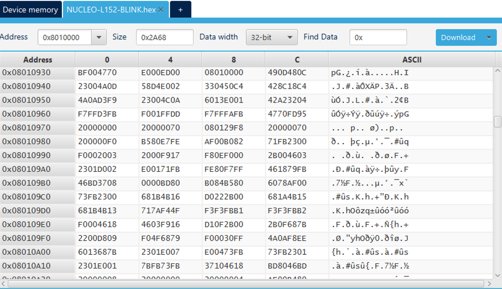

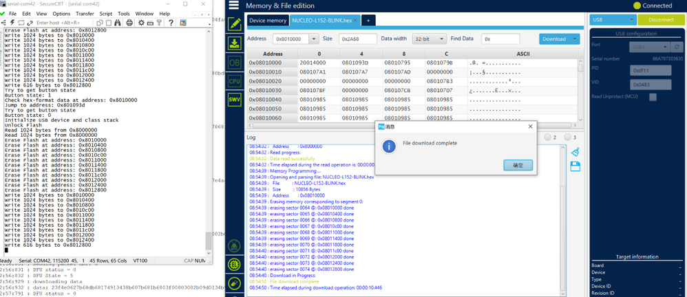

After upgrading firmware, I pushed the reset button to make the MCU power-cycled. Then the bootloader identified the App firmware (base address = 0x801000) and tried to jump to "0x801093d". However, no expected logging information shown and LD2 didn't blink as wished as well.
Try to get button state
Button state: 1
Check hex-format data at address: 0x8010000
Jump to address: 0x801093d

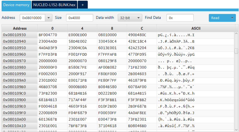

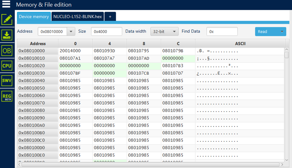

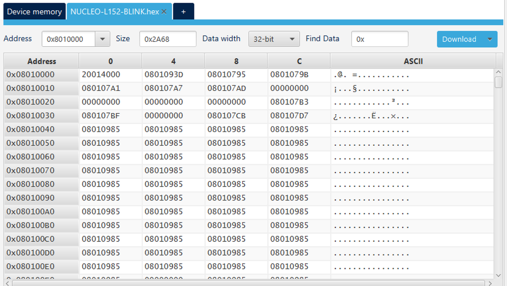

I analyzed the App hex file, the starting-point address shoud be correct.
And the bytes in chip flash coincides with the data in hex file.
So I could confirm that the DFU programming process is unquestionable. There must be somthing wrong with the App firmware.
Could somebody help find the root cause why the APP firmware couldn't run as expected- output logging information during blinking peroid?

For each of the projects, if you run it standalone in debug mode (in STM32CUBEIDE), everything is just fine.
However, if you program both of them (two hex files: bootloader to 0x800000, app to 0x810000), just log information of bootloader will show on the screen:
xxxxxxx
jump to 0x81xxxxxx,
And then nothing is displayed - expected App firmware log don't display on the screen at all.
In the other side, I could upgrade firmware in DFU mode inside STM32programmer tool.
But after upgrading and power-cycling the board, the same thing just happens- no expected App firmware log information is shown.

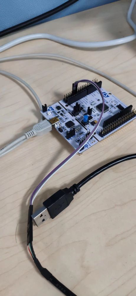

Ok, but board NUCLEO-L152RE has only one USB connector (for STLINK) so what are you adding to get DFU working on STM32L152 ?
2021-09-29 9:31 PM
I took use of one 4PIN-to-USB cable to connect the board to PC.
The pin definition is : D+ (CN10-12), D-(CN10-14) and GND-(CN10-9).
2021-09-29 9:33 PM
Please see the purchase link below:
https://detail.tmall.com/item.htm?id=629908291799&spm=a1z09.2.0.0.7e692e8dSNiPES&_u=u1k5qcbd1c5
