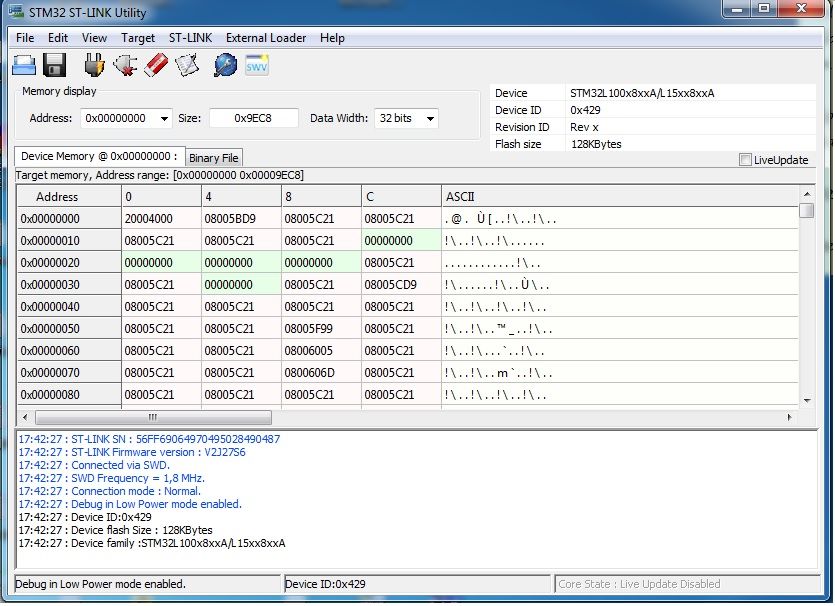

Hi
Nayani.Parmin
,Could you pleasecheck with STLINK-Utility @address 0x00000000 if boot is configured to system memory where bootloader resides or not ?
Thanks
Imen

Hi Imen D,
Here is the screenshot of the memory
Hope this will help.
