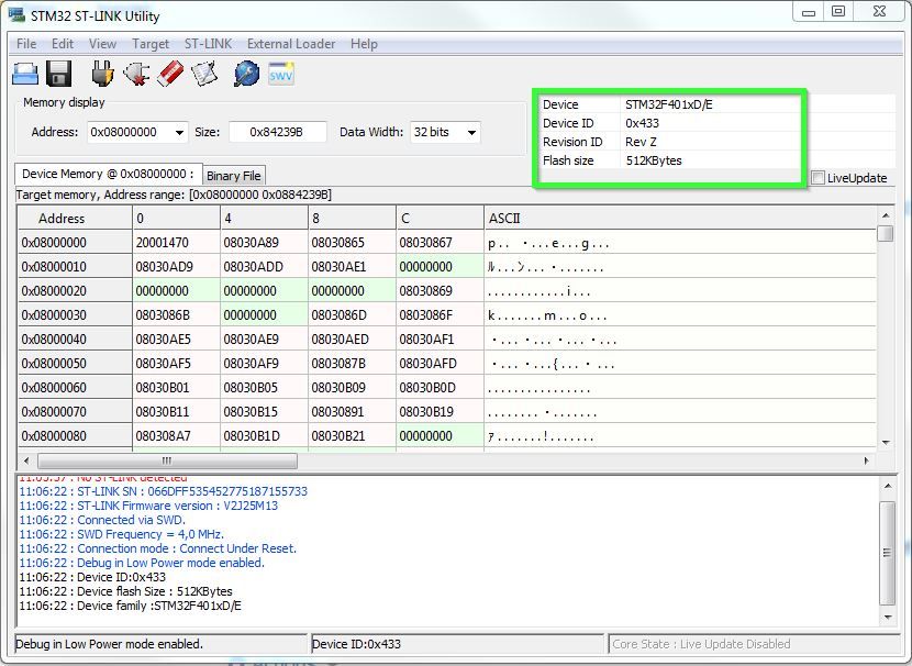

you can also use the STLink utility.
After connecting you see the device ID and dice revision on the main screen.

Hi Max and Clive One,
Here is the ID
got from ST_Link.
