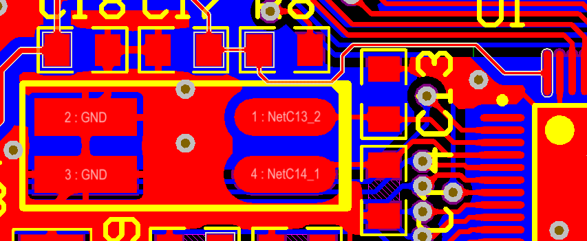

Here is the Layout:
The bottom polygon is connected to GND too.
C13 and C14 are crystal Caps, first i used 12pF caps, no result.
I changed it to 10pF and now it works !

These 32.768 KHz crystals are usually available in several standard load capacitance flavours, typically around 6, 9 or 12pF
The drive characteristics of the STM32 has generally favoured the 6-7pF variety, although newer families have become more tolerant.
A lot of the DISCO/NUCLEO-64 board use this part (often not placed but in the BOM as an option), I've used these to add RTC functionality in STANDBY
32.768KHz 6pF 20ppm -40C +85C
MC-306 32.768K-E3:ROHS
https://www.digikey.com/product-detail/en/MC-306%2032.768K-E3:ROHS/SER2417CT-ND/1532560
Obviously you'll need the MC-406 variety, and I would expect 6.8pF capacitors.

according to AN2867, we should consider Cs too. i sent my PCB Layout, how much Cs you estimate for it ?!
I cleaned PCB by ultrasonic cleaner and almost the surface of PCB is clean. only capacitance between tracks and pcb remains ...
