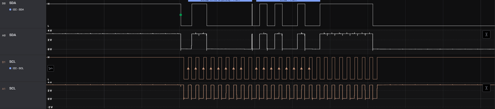

I have an STM32L073 communicating with an IS31FL3246 LED driver over I2C. Occasionally the MCU will not send the 9th clock pulse and therefore locks the bus. (As shown in the picture the analog signal has a valid waveform without much noise)

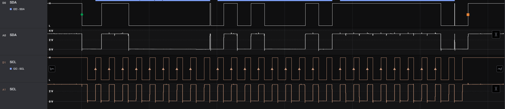

Before this happens there are several valid I2C transactions like this one.

2022-05-30 2:39 AM
Could you please confirm us some information please ?
Do please confirm that the issue occurs when the master is writing the slave please ?
On the faulty capture, it looks that slave ack is missing...
Last point, when the issue occurs, could you please read the I2C_ISR register to get the status of the I2C peripheral ?

2022-05-31 2:22 AM
Yes, this happens when the master (STM32L073) is writing to the slave.
Yes, that is because it doesn't get a clock pulse from the master where it can send the ack. The issue is that the 9th clock pulse is missing...
The ARLO bit is set but there are only two devices on the bus, the master (STM32L073) and the slave (IS31FL3246).
Regards
Gustaf
