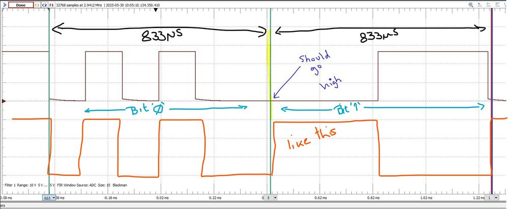

I am trying to impliment a frequency shift keying (FSK) routine to represent a each bit of a byte as FSK.
My routine is kind of working (see the IRQ for TIM3 below). My FSK is :
Bit 0 & Start : 3600Hz
Bit 1 & Stop : 1200Hz
This ensures that timing is alway 833.3us, and transisitons only occur at the end of a full cycle (avoiding glitches).
In this example pictured I am sending a 'U' to be encoded (this has a binary value of '0b01010101') so its easy to see the FSK changes.
What I've noticed is that when I change from bit from 0 (3600Hz) to 1 (1200Hz) the output polarity keeps the previous polarity level. This makes it look like last pulse of the 3600Hz waveform is streatched.
My question is, How can I change the polarity of the PWM ouput on each sucessive bit?

2025-05-30 9:42 AM
Hello @mikeyd0407,
This behavior is likely due to that the timer's output compare does not reset its phase or polarity when the frequency (ARR value) is updated, try forcing the timer to reset its counter by adding this line in your IRQ handler:
htim3.Instance->ARR = current_bit ? (48000000 / 1200) - 1 : (48000000 / 3600) - 1;
htim3.Instance->CCR1 = (htim3.Instance->ARR * 50) / 100;
htim3.Instance->CNT = 0; // Reset the timer counter to zero
Hope that helps!
2025-06-02 2:25 AM
Hi Sarra.S,
I tried your suggestion, but unfortunately it doesn't eem to change the polarity. Any other ideas?
Kind regards
Michael
