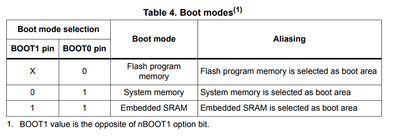

Option A - we have SWD and UART options available on the custom board but in case there is some issue with hardware and SWD/JTAG is unavailable.
Option B - Seeing the table below and reading that "The nBOOT1 bit is located at bit 31 of the FLASH_OPTR register, which is initialized to the value 0x807000AA during the production process. " made me worry if Boot Mode is changed to Embedded RAM then bootloader code might not be executed which is needed to flash firmware from USB or UART interfaces.
