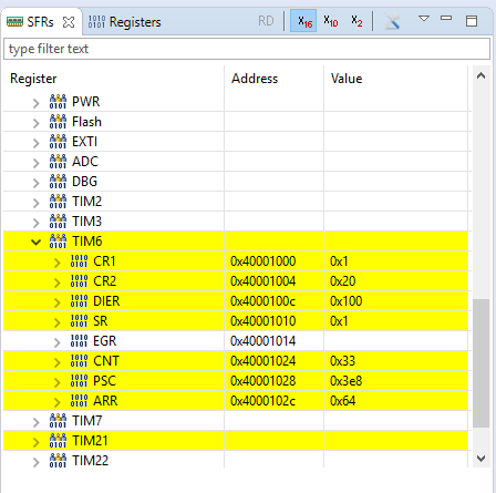

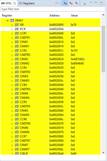

2017-10-11 7:40 AM
You can see the content of registers bellow:
Thank you, Jan.
2017-10-11 8:06 AM
Both DMA_CNDTR2=0 and DMA_ISR=0x07 indicate that the DMA has already run into completion.
2017-10-11 9:01 AM
Dunno. Post the content of relevant DMA and TIM registers.
