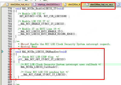

Is HAL_RCCEx_LSECSS_IRQHandler defined? It's not in the code you presented.
Thank you for your reply
RTC interrupt has been enabled.
HAL_RCCEx_LSECSS_IRQHandler  in the HAL library.

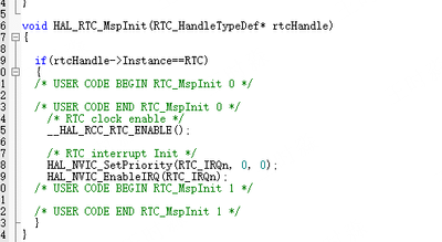

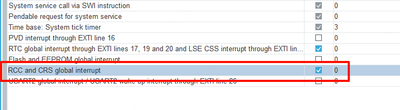

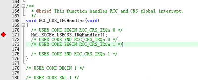

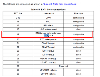

I checked the manual. CSS_LSE IT is mapped on RTC EXTI line 19.So I enabled the RTC interrupt.
I also tried to open this interrupt, but cannot be triggered.

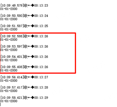

Hi,Simon
Thank you very much, I have successfully triggered the RTC CSSLSE interrupt.
