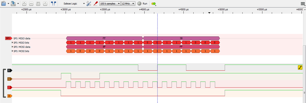

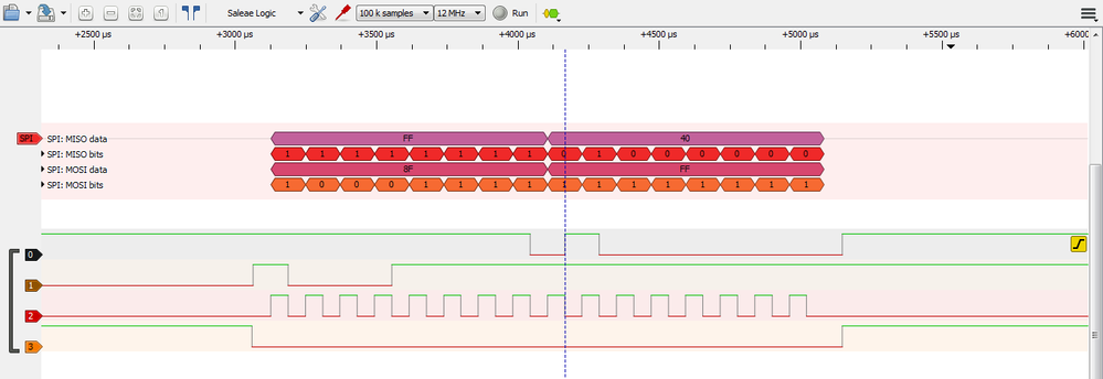

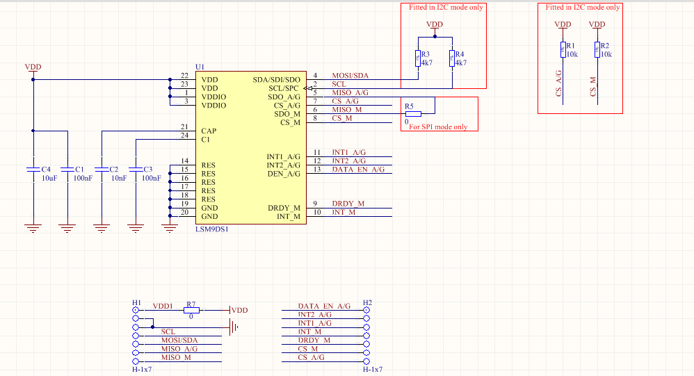

Hello, we are having problems with communicating to sensor LSM9ds1tr via SPI with sm32l011k4 mcu. The problem is that SPI seems to work good and looking with logic analyzer proves that everything is okey, we are seeing exactly the same thing as mcu reads. We are trying to read the WHO_AM_I register of accelerometer/gyroscope and magnetometer and for some reason we read wrong values compared to the datasheet. According to the data sheet, then reading ACC/Gyro WHO_AM_I register the value should be 0x68 and then reading Magnetometer WHO_AM_I register the value should be 0x3D. However, when reading these, we always get 0x40 when reading accelerometer/gyro register and we always get 0x38 when reading magnetometer WHO_AM_I register. Could anyone help us to solve the problem and point out what we are doing wrong? I attach the schematics of the sensor, spi initialization code and our reading function + snapshots from logic analyzer.

Wow, when you zoom into the logic analyzer image there is much more detail...
over 55 now, eyesight with focusing is difficult.
I can see on the data sheet, that address 0x1F looks suspiciously like your data...
try reading registers 0x21,0x22,0x23...
your CPOL and CPHA look good.
how long is the data cable ?
what speed are you running, 10khz ? this should be no problem.
where did you buy the chips ?
do you think they could be counterfeit ?
I have been touched by counterfeit product a few times...
Pins 7 and 8 should be low, did you check that ?
what is pin 13 all about ? no details in this sheet, looks like it needs to go high.
