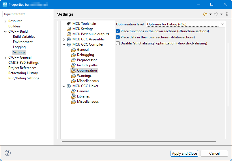

Have you tried increasing optimisation yet?
One key optimisation is that unused functions don't get included in the final image ...
GCC Optimisation levels are documented here;
https://gcc.gnu.org/onlinedocs/gcc/Optimize-Options.html
"-Og should be the optimization level of choice for the standard edit-compile-debug cycle, offering a reasonable blend of optimization, fast compilation and debugging experience" - see here.

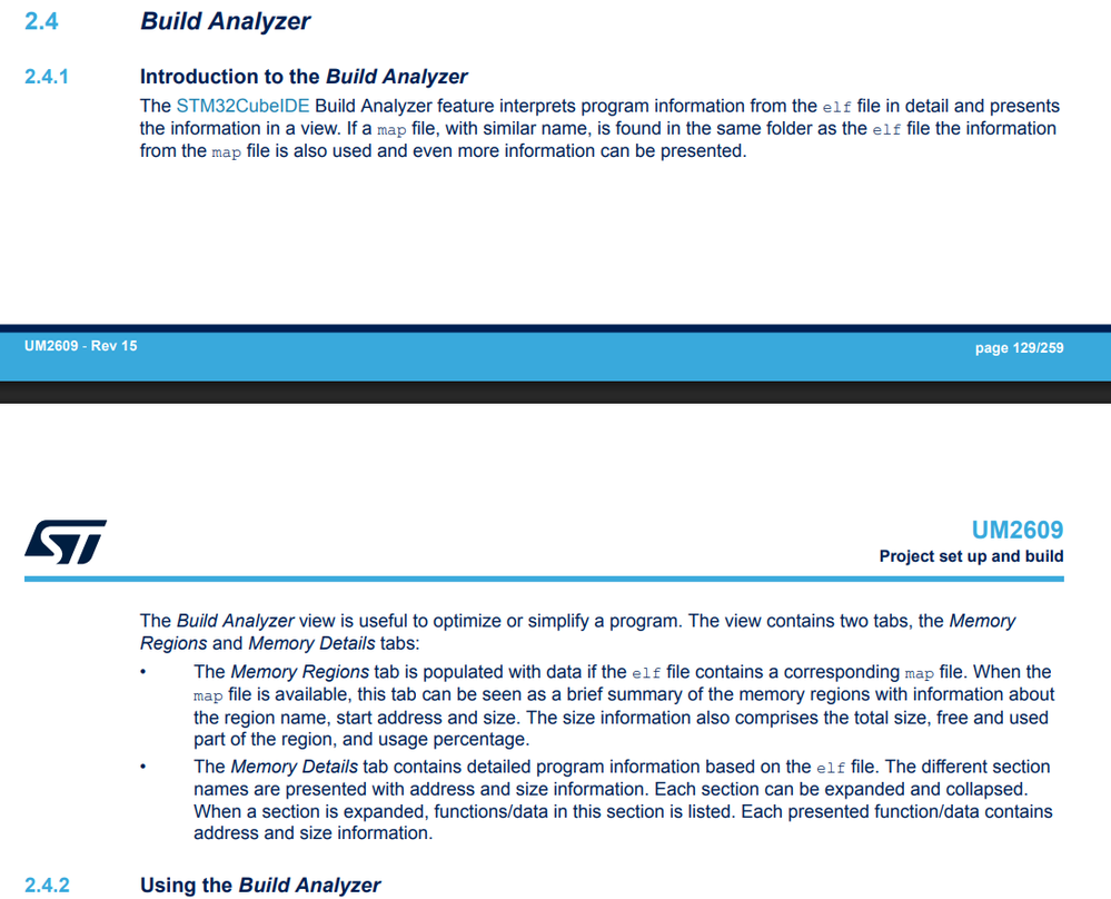

Use the CubeIDE Build Analyser to see what, exactly, is using up all the space.

As @TDK suggested, try a higher optimisation setting.

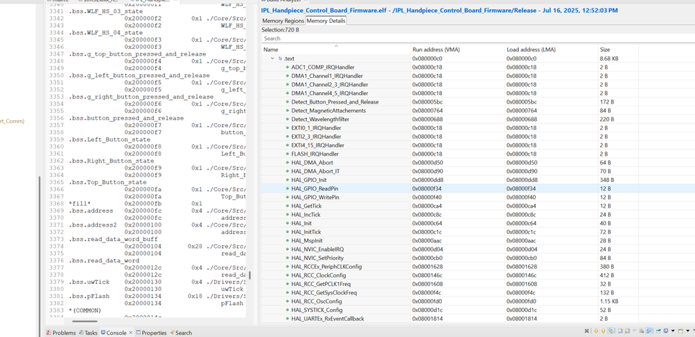

Thanks for the reply, Yes tried to go as per your suggestions, I can see the HAL functions and some Implemented functions (these having lower size), so any best possible way to optimize more and use the code ?
2025-07-16 2:47 AM - edited 2025-07-16 2:50 AM
Try sorting the list by size, and look at the largest things ...

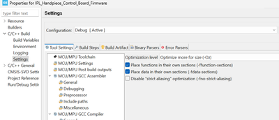

2025-07-18 3:10 AM
Hello @Andrew Neil,
Yes Sure,
For me I have removed some additional wrapper functions (Which were created for STM32H series Application, used in other project for some additional check and validation), now I have used simple HAL functions which are created during code generation.
Disabled and removed the I2C from .ioc , (which is not going to be used any more).
Then tried to Optimize from Properties settings to "Optimize More for size (-Oz)",
This worked well without any trouble in firmware operation.
