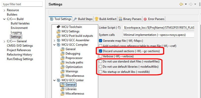

2025-12-01 8:34 AM
So what was the flash use percentage in the CubeIDE build ?
Have you done a thorough check of all the other settings; eg,
Do you get a map file from the CMake build?
Note that the full command line appears in the Console when you do the CubeIDE build.
2025-12-01 9:30 AM
Other compilation flags are exactly the same; I can't find any differences.
CubeIDE reports 100% RAM usage and 99.35% flash usage, so it's very close to the memory limit. Comparing the map files, it seems that more code is being included in many sections.
But I don’t understand why, the project and the libraries should be the same. Why does it change when using the CMake toolchain?
