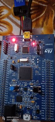

In my board LD1 only RED colour LED is blinking. Is is hardware faulty or some other issue .

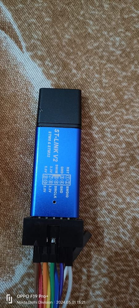

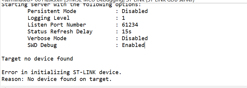

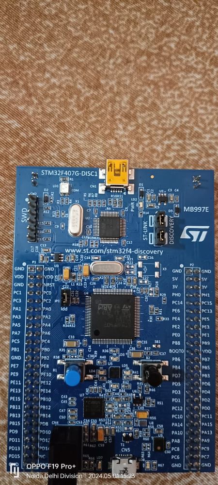

Kindly provide pinout diagram b/w ST-LINK V2 and STM32F407G-DISC1 also share , solution for Debugging issue
