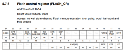

Maybe by manipulating FLASH_CR register, setting OBL_LAUNCH bit to 1 and wait a bit. Maybe you'll need to re-attach the openocd connection because it will reset the target.

2023-10-30 11:50 PM
Hi, no, this does not work. Only thing that helps is to do a Power On cycle when the debugger cable is attached
